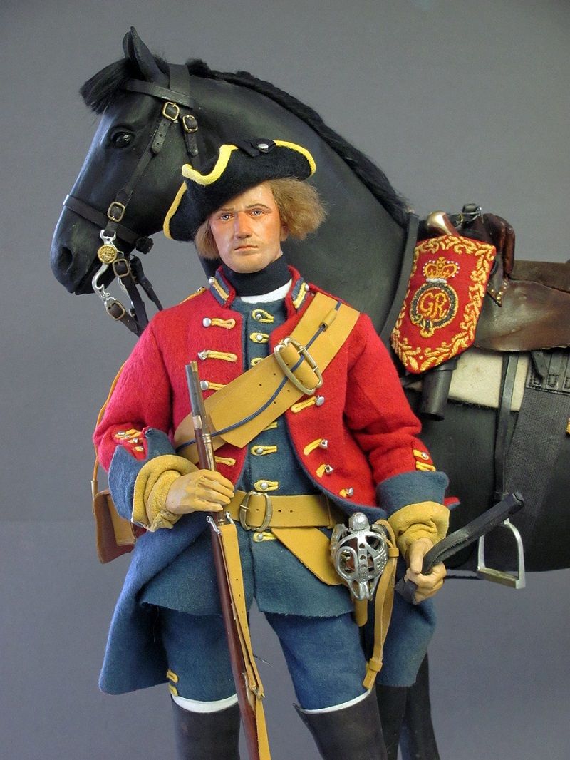

The uniform is based on the 1742 Cloathing book , and a modern Pierre Turner plate in Michael Barthorp’s indispensable “ British Cavalry Uniforms 1660…“ , which gave me the idea in the first place. The basics of the uniform come from the information in that book.

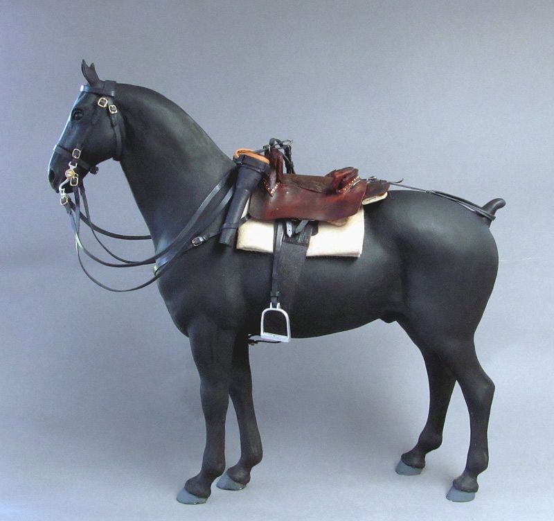

Saddlery :
Before the sealed patterns of the later 19 century, we have to make intelligent guesses, because the real objects don’t survive , and the paintings are ambiguous . I have followed the 1:1 reconstructions made for re-enactors by Stuart Lillie. The saddle is little changed from that used a century earlier, or even now in Spain and Portugal.
Made of leather over a wooden tree ( I use walnut ) and padded with tow. It has a pillion , a little extra saddle behind the main one, on which the rolled cloak rests. The elaborate housings were embroidered .
Uniform :

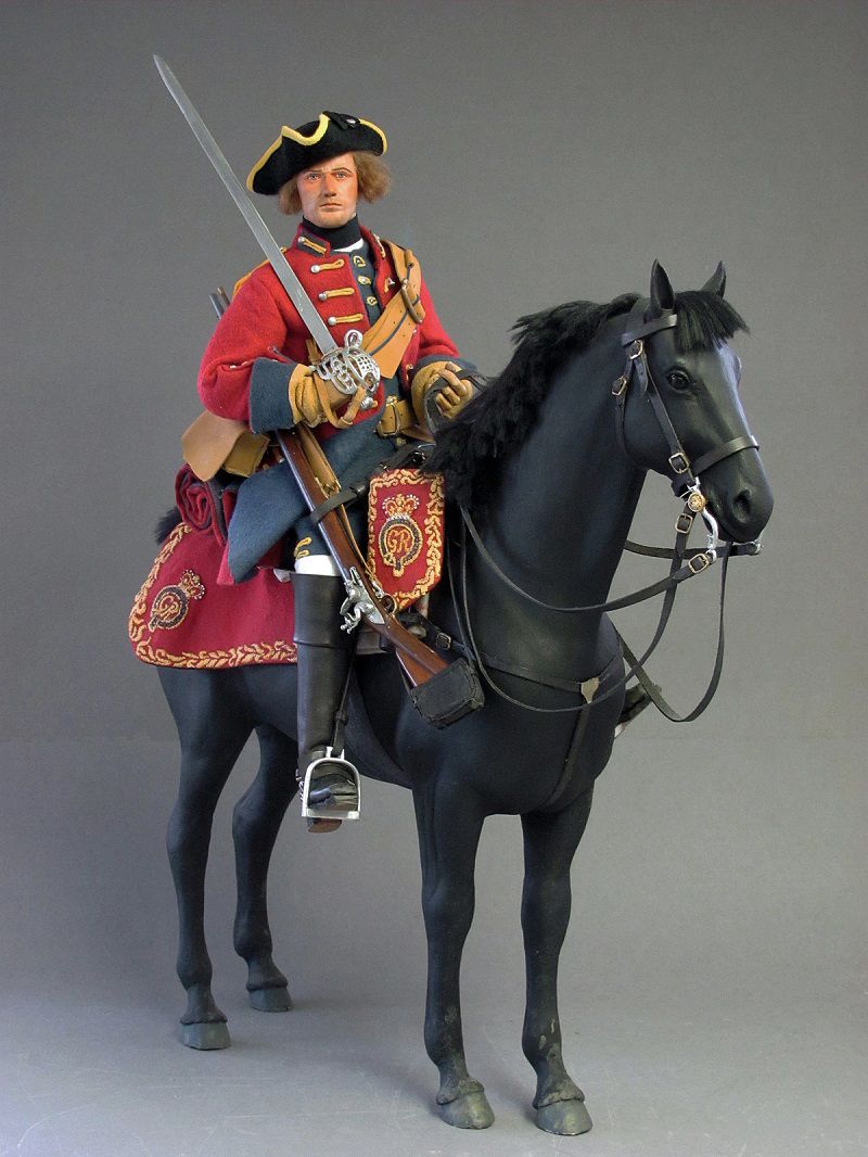

Each Dragoon carried two large pistols as well as musket and a basket-hilted broadsword .
The hat conceals a secrete , a cross-shaped iron head protector .
The coat is fairly plain compared with the Foot , with simple yellow cord buttonholes and the unusual mid-blue facing colour.
The pouch and belt are buff , with a separate powder flask on a cord.
He wears a shoulder knot of yellow cord, which denoted a Corporal in the Foot, but all Dragoons wore them , perhaps as a mark of the superior status of Cavalrymen .

The body is an HT slim. They sit a saddle beautifully.
I have reconstructed his pre-battle face from the engraving as best I can. His hair is mohair .
All the uniform cloth is brushed cotton , dyed and then painted to perfect the colour, and to stiffen it .
The buff leather is goatskin, the coloured leather is calf specially thinned.
The pewter metalwork modelled and cast by me ; brass work modelled by me , then cast in Birmingham by Beechcast .
Boots are wet- moulded leather , jacked into shape over a former, stained and sewn up the back like the originals.
The basket-hilted sword was a bit of a nightmare, since it had to be cast in bits and soldered together, a tricky business since it might melt… but I got away with it !
I have since discovered that there is a surviving brass-hilted sword possibly associated with Thomas Brown . But I’m not going to change it now !
The dating of mid-18th c swords is very imprecise anyway , since there are no official patterns in use, just Regimental ones .
The musket is the Short Land Pattern with a wooden ramrod, which was originally the Dragoon-length weapon , adopted by the Foot after 1768 .
The embroidered ornamentation on the housings and holster caps is embroidered by hand , then overpainted to tidy it up.
The horse:
“Mad Jack “is a heavily rebuilt Cindy horse, made longer , wider and taller with plastikard inserts and with an entirely new head and neck. Black horses with savagely docked tails were the norm at the time .
